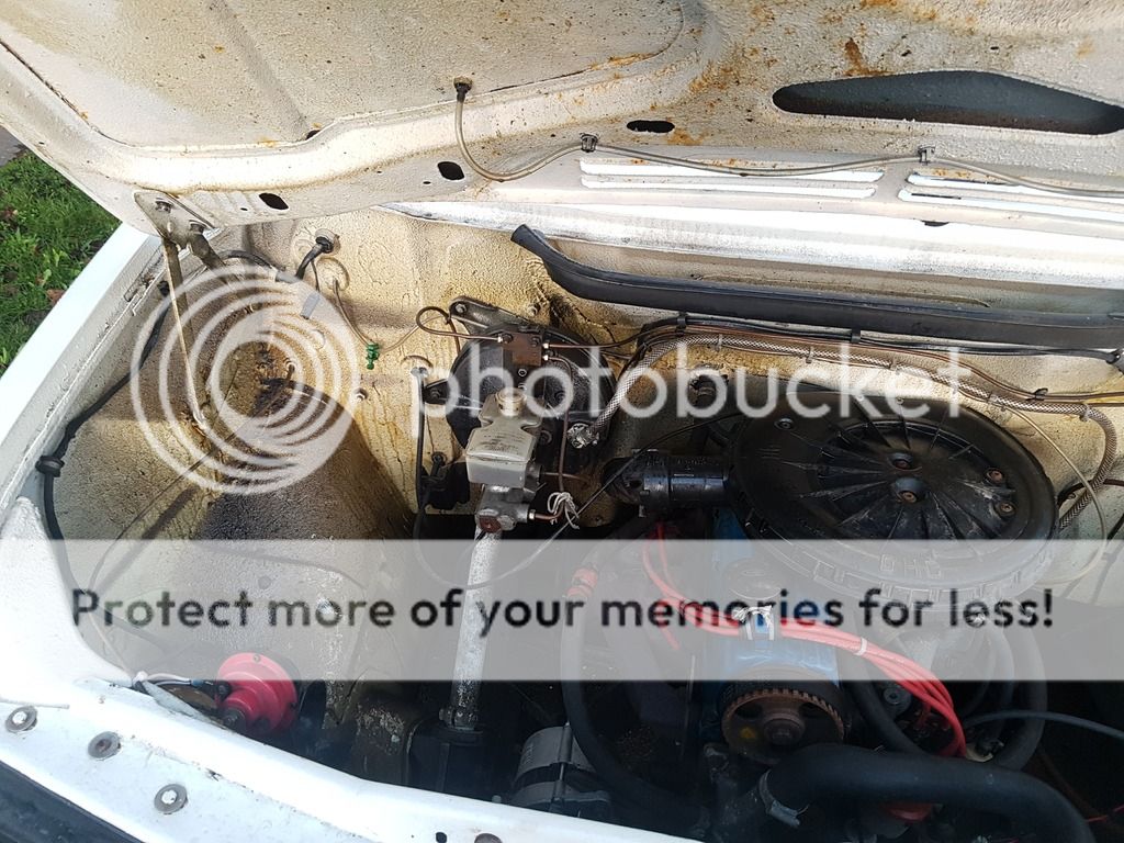

Another issue I had whilst on an Xmas trip to lancashire was the oil cap coming off and exploding oil over the engine bay on the A1. It luckily happened as I pulled into fuel… the cap landed on the exhaust manifold and was starting to melt but I managed to retrieve it before it went up! Not sure why, but maybe it was on loose/worked loose. Anyway I’ve tied on a replacement I had on one of my spare engines and will keep an eye out on it future. At least it adds some rust treatment to the engine bay...

On the way back from dropping the quarter off at the repair shop I picked up a PCV valve and grommit from Burton power to help with oil cap issue. Had a half hearted attempt at fitting but gave up after I couldn’t get the flame trap out and it started raining. I also thought I’d be better off reading a haynes manual first rather than forcing it.

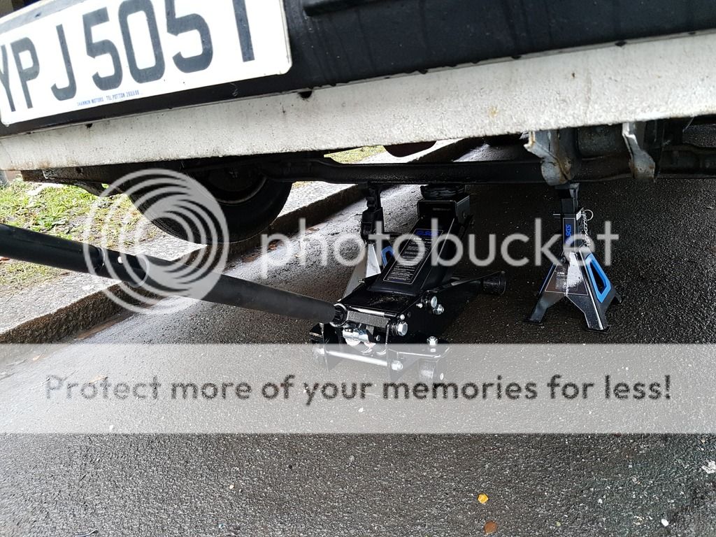

I did however manage to try out my new 3ton jack and stands from SGS engineering. I’ve got the 2.5 ton low profile jack already and the transit had fallen off once (as above) so invested in this as has a wider lifting point. Its seems well made like my other one so happy with it.
What I wanted to check when I jacked it up was there is a creaking noise coming from the drivers side suspension that is getting worse. I wanted to make sure leafs weren’t about to drop off… which they aren’t. The rubbers in the springs look pretty knackered so reckon it is that. I’ll look out for a bush kit and do a refresh of both sides or check the spare leafs I’ve got in the garage and swap them in.

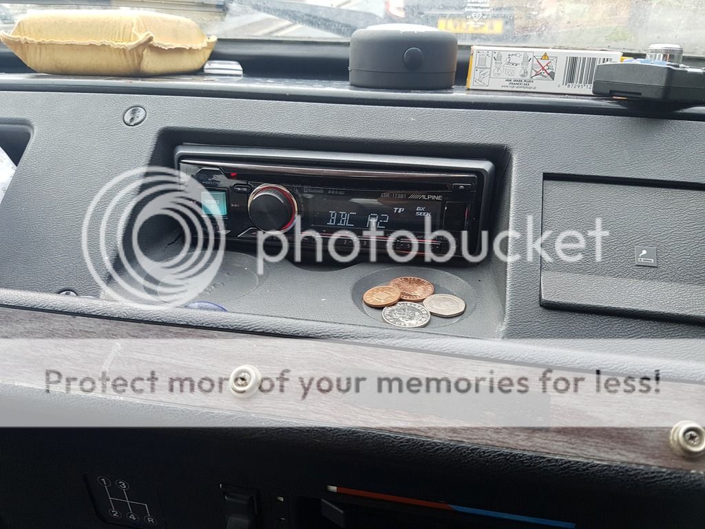

As it had started to rain I retreated indoors and took the old stereo out. (Old archive pic)
I then took the stereo that I had removed from my XR3i
And fitted it back to here
Happy days - much better sound and also tunes into radio stations considerably easier.
