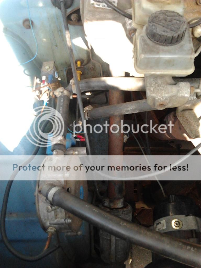

Couple of underbonnet photos of the LPG setup with the BLOS LPG carb Vapouriser
Post by muttleymk2 on Jun 15, 2014 19:16:38 GMT 1
Sweet, all coming together nicely matey
