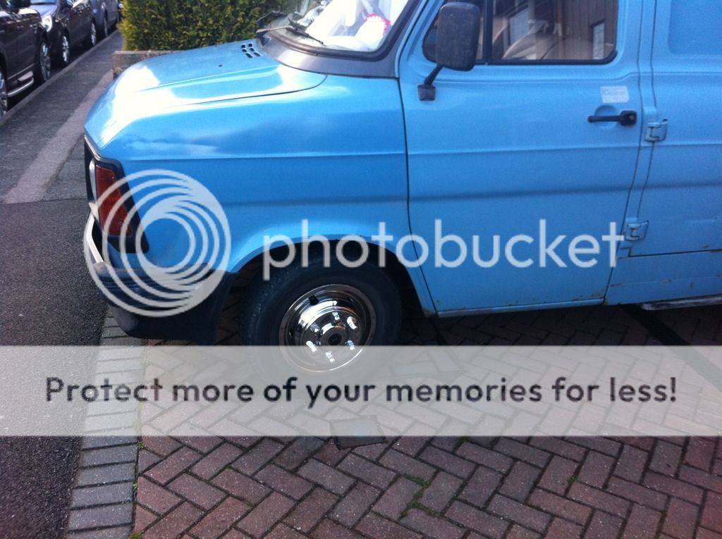

Post by dodgerover on Apr 5, 2016 23:37:45 GMT 1
Got some new Euroliners!!! Only got the fronts fitted though because I want some longer thread extenders making for the rears, the supplied ones are ok but would prefer a little longer.... Doing 70ish miles a day at the moment going to and from work. Going to be ever such low mileage soon Screen is leaking again - poxy thing, at least its not soaked the replacement CB again. In other news I've got a TPS megajolt so I can play with timing curves etc and I'm putting the parts together to get it running, also converting to a flat poly belt rather than the existing v belt, got the main pulley with trigger wheel attached but it needs machining to suit. Got an EDIS 4 and plug but just need coil pack and mount and crank sensor and mount and the associated plugs, breakers wanted a fortune (well more than I could buy new ones for without plugs) so if anybody has a dead ford going for frag locally I can pillage please let me know Also underway is installing a lamda feedback system to control the LPG, not sure how successful this will be but I had all the bits anyway so nothing to lose.
Post by FredTransit on Apr 6, 2016 12:57:51 GMT 1
I like the Euroliners, but the rest of your post seems to be written in Martian...
